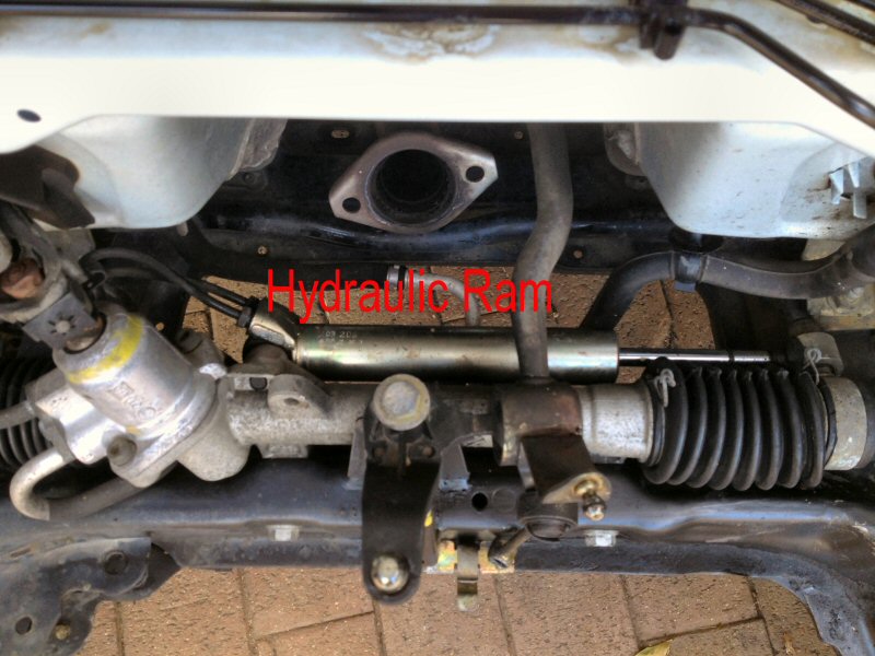

Hey Anthony, just saw this topic again and came back to reply. I'm not sure what you mean by RAM, give me some more info or pictures. Also just so you know the power steering is still on my Berlingo, I may consider removing it one day when it fails but I want this car to be driven by other people when necessary.
The Power steering rack I have is setup with a hydraulic ram bolted to the back of the rack that assists the steering effort needed to steer the car. So effectively this is a manual rack with hydraulic ram assistance.
[Image: IMG_2072.JPG]
So my question was "Did you remove the Ram from the rack or just leave it in-place and removed the oil only?" with the ram being the hydraulic ram pictured.

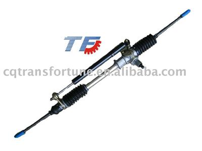

My thinking was to possibly remove the ram and replace it with a steering rack damper similar to this one.
[Image: steering_damper.jpg]
The damper is just there to help soak up the bumps and not much else... not something you need on a race car.
