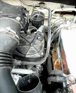

Is the top pipe the air intake I'll spray the egr cleaner into?  Just want to confirm before I start.
[Image: imagejpg1.jpg]
This isnt my van this is a picture i found online., mine is a lot cleaner.
Thanks in advance
