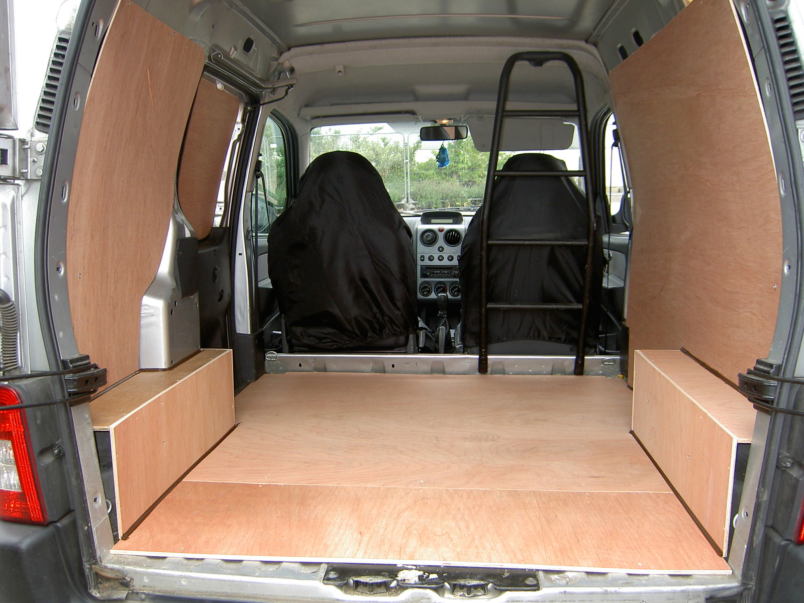

Having a closer look, it looks like the bottom of the bulkhead bolts onto the lip of the load floor which obviously isn't present in the car version so a custom wooden one is the only way forward.
Pic of drivers side cage bolted to the load floor lip.

I bought a berlingo car version for exactly the same reason, most of the van versions in my budget were well hammered.
I've considered fitting some sort of bulkhead and the best way to tackle this would be a custom ply one. If you are worried about being flattened by your rear load in an accident, maybe fit a couple of steel bars or fit a seat bulkhead, I'm sure you could pick a s/h one up from a scrappy on ebay.

I looked round local breakers but never found a full bulkhead & full steel bulkheads where over £200 new so i went to b&q an paid £11.60 for a 8x4 sheet of 18mm mdf. Utilizing the bars fitted behind a vans drivers seat for added strength my bulkhead spits horizontally to facilitate the angle of the seats for the lower half and is secured with some strong steel brackets where necessary, finished in a black chalkboard paint makes it look the part too , was even able to create a locking hinged access over the passenger seat for them longer items. Even had enough mdf left over for a custom shelf unit opposite the side door, was tricky getting the cuts right around roof space an side door but well worth the effort on the saving. I cannot stress enough about the importance of the security of all fixing points though , if in-doubt take a look at some factory fitted ones.
