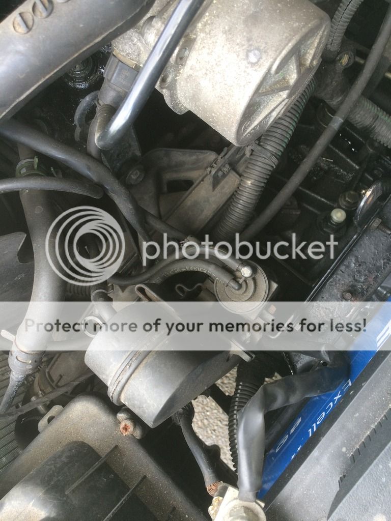

I did get it to start after about the 20th time of trying (just made a single click noise on the turning of the key), took it for a long drive to get some charge back in the battery, got home and then it wouldn't start again and was making a whirring noise from this area (see pic), could pin point exactly which part it was though, any ideas?
[Image: 004_zps78zn6f8l.jpg]
Engine/gearbox earth strap or starter motor cable ?.
That's assuming that the starter motor is not turning when it will not start. With a new battery and starter motor its something common to them both. Your picture shows bare wire (middle bottom) on the starter motor cable ? , looks dodgy to me.
The whirring noise may be caused by the vacuum pump and valves allowing the air pressure to equalise.
Clean all connections,live & earth on battery,starter & engine earth strap.Use jumper leads to bridge earth circuits & it should pinpoint where the fault is.Clean connections means unbolt & emery/wire brush,not a tickle & hope job.
