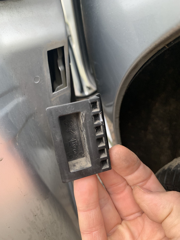

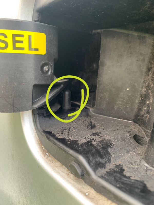

I fixed mine so I thought I’d update the thread,
It was clear when I looked at another B9 Bling that the plunge had dropped as it wasn’t fully in contact with the plunge path on the flap, it had dropped about a third to a half.
To fix I pulled the plunger up and it kind of clipped into place, I opened the flap pressed the plunger in as far as I could with my finger and CAREFULLY cracked the door then gave it a little tug so it didn’t contact the door, then this bit of plastic fell out and the door opens fine!
I may or may not order a new plastic part.
The picture is of the plunger after it’s fixed, even when damaged the action still felt the same and was clearly moving the cable just not enough.

Well done, this is the first time I have seen a resolution to this problem.
