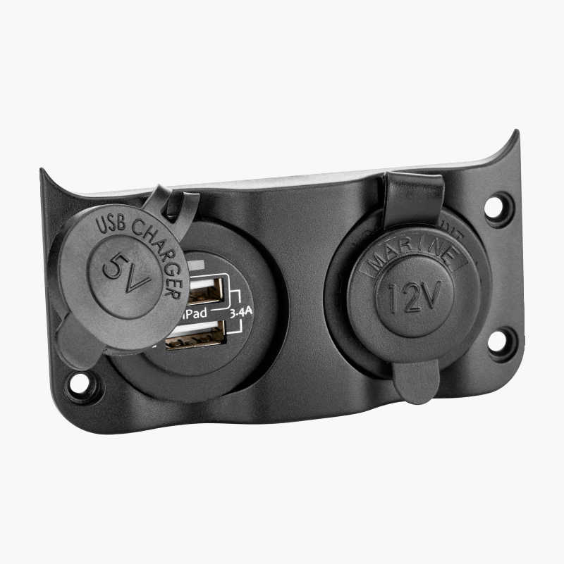

Anyway, you may want to add another port somewhere inconspicious for the adapter, so that you can still use the regular one for charging cell phones and whatnot.
I bought a 'double size' with one 12V port, and 2x USB ports, both behind rubber dust covers.
[Image: 2]
You can find similar stuff in boat equipment stores.
(This one was from the boating section at BILTEMA, a Swedish HW chain)
I mean, if you're going to mess about behind the dash anyway, it won't hurt to add a bit extra functionality. ;-)
