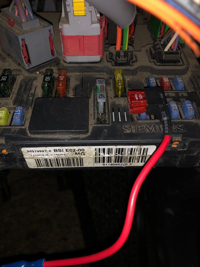

Mines a 2008 berlingo xtr 90, (same shape as 2006/7 etc) any idea which fuse it is?
If you have an M59 berlingo undo the two clips and drop the BSI down a bit and the shunt fuse is in the front row in the middle if I remember. I think its marked on the BSI or in the handbook. It stands out as the fuse holder slot is longer to take into account of the two positions of the fuse.

[Image: FD95448F-05C8-455A-9E1E-FA075D22179C_zpsanjajbta.jpeg]
Do you mean the one with SH on the top? It’s really weird it will fit in the current position but when I try the other position the fuse is too big.
Ok I’ve managed to get the shunt fuse into the other position but the cig lighter still doesn’t work when the key is out of the ignition. Any ideas?
