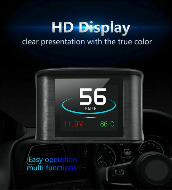

You could purchase one of the cheap OBD II display units that are on sale on eBay (other on line sales places are available) I use one in the Picasso as it doubles as a rev counter, but also displays the water temp in degrees (F or C) much more visible and accurate than the gauges fitted to the car.
[Image: s-l640.jpg]
They are OK for £20 or so and double up as a code reader though they dont cancel codes thrown up.
As long as the car gets up to 87 / 88 degrees then its working as it should do.
