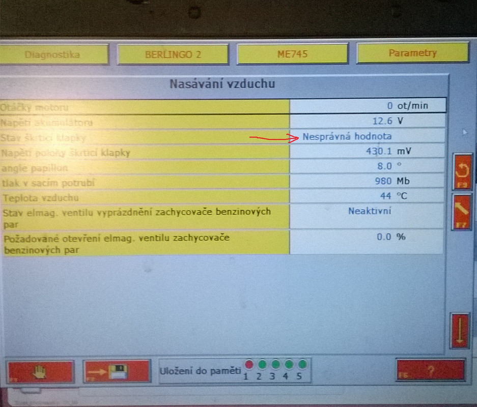

[Image: skrtici-kklapka.jpg]
good day,
please, give me an advice. Diagnostic reports incorrect throttle position
high gasoline consumption
is there any reset settings?

It's a bit difficult to tell what diagnostic screen you have displayed. But, if you have an incorrect throttle position, maybe it's the throttle position sensor?

The obl2 car scanner diagnostic shows a constant opening of the throttle at 18 percent
when starting the engine runs up to 2000 rpm but immediately returns to the correct value

[Image: skrtici-klapka-service-box.jpg]

Berlingo 1.6 NFU 2006 ecu ME745 gasoline
hello everyone, please who have a diagnostic-reader of real values (Lexia etc.) so I would need help if someone would be willing to connect their car and read the values while the engine is warm: (or photo video)
