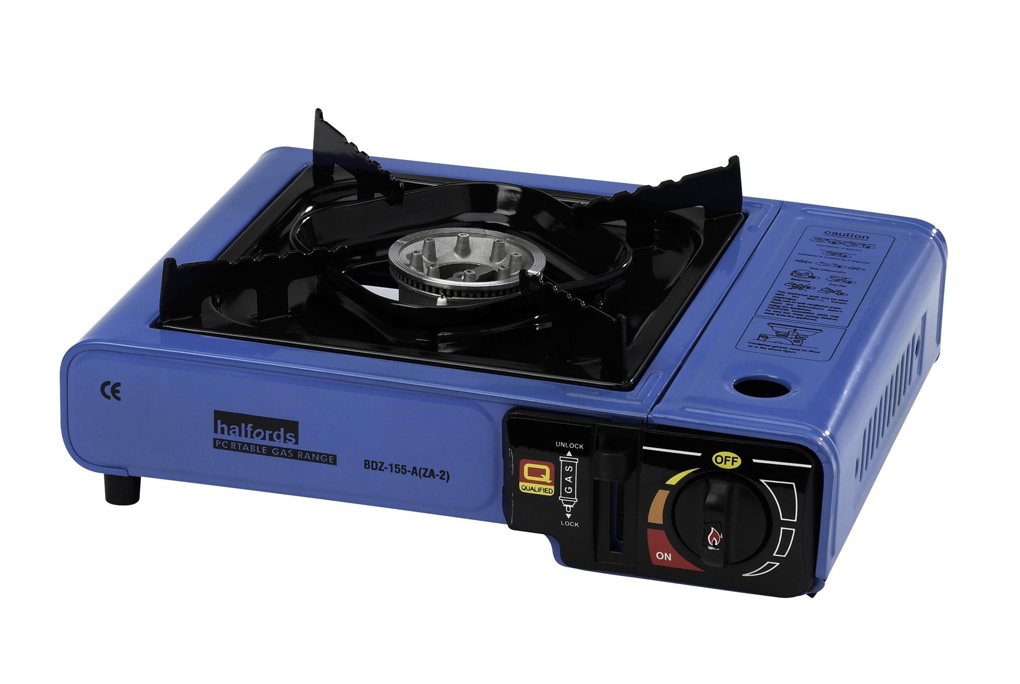

Hi - on the gas stove/carbon monoxide topic...
We have something similar to this:
https://i1.adis.ws/i/washford/291036?w=7...t=webp&v=1
i.e. cheap Chinese single burner that takes small cartridges. Recently we had a scheduled power cut so grabbed the gas stove to boil up a pot of water for cooking. That kicked off the CO alarm that is in the front room next to a log burner (i.e. about 12 feet away from the kitchen and through two (open) doors).
Reading was 400 parts per million but who cares as we didn't hang about long enough to worry. Sure it was a low battery in yours? I'll not be using ours again inside a house, tent or caravan any time soon.
