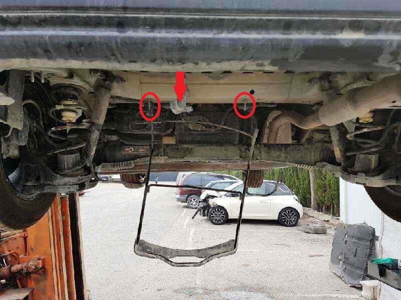

Can you send pictures of where you fitted the carrier to?
You mentioned you had to jack up the car significantly to fit the carrier on the mounts, can this be achieved using a normal car jack or would a mechanics pump jack be required?
Thanks
It's chucking it down with rain here and as I park on the road, I'll not be getting back underneath it for a day or two at least. What I can do is post a photo of an old Berlingo from the internet that should help, the mountings are just about the same.
The red circles are the brackets with oval shaped holes protruding down from the rear cross member.
The red arrow points to the holding up bolt you undo from inside the boot to drop the frame down.
See if you can line up the brackets from the photo with what you see under the back of your car when looking from the same angle as the photo, i.e. from directly under the rear bumper -
[Image: Belingo-spare-wheel-carrier.jpg]
As for jacking it up, I used a normal scissor jack but it was near at the top of its travel and as I raised it I used an axle stand at the side of the jack and raised it hole by hole just in case.
