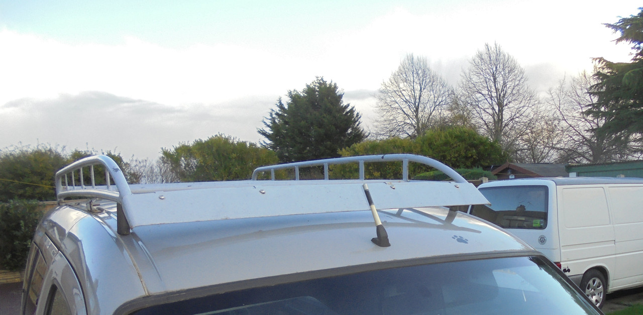

Not had a Rhino rack but do have Citroens own cage type rack on my M59, won't take an 8 x 4 sheet without hanging it out of the side slightly. I have a stub aerial so no problems at the front.
I have had Halfords bike carriers on it using U bolts in the past with no problems.
It replaced Citroens own crossbars which needed tightening constantly both when loaded and unloaded. Even so I once lost 3 bikes on the bars at 50mph when on holiday!
[Image: DSC01229-2.jpg]
