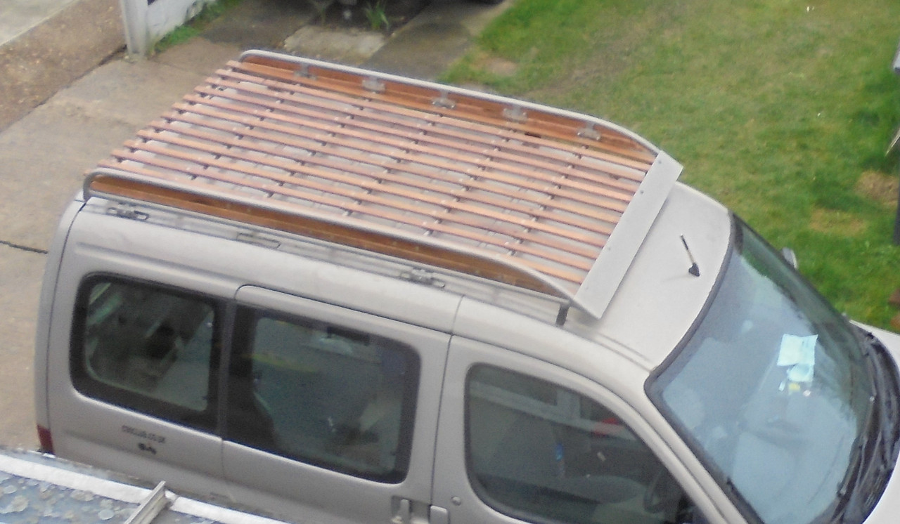

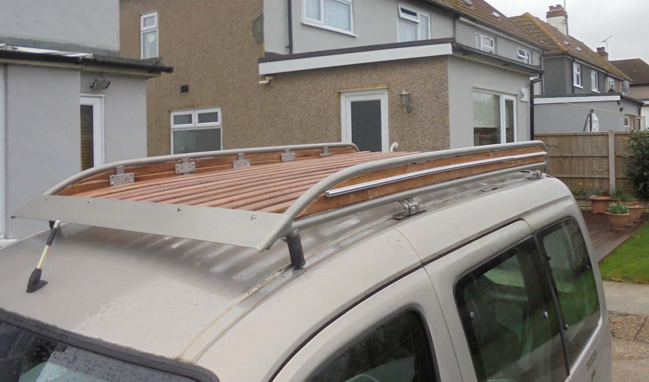

Had a scruffy old Citroen/Peugeot van rack for years. Also some old mahogany garage doors, loads of stainless fittings and some rattle cans of Primer, Sable Bivouac and lacquer. Most of all I had a load of time.
The idea is to attach more awning C rail to both sides and the back to attach my drive away.
I'm happy.

I didn't see straight off that the extra slats were wood - I thought they were a sort of antique 'rusty metal' effect, then I realised, lol. Actually makes sense to have wooden bottom slats - over time I've found that the protective coating on the metal of my M49's dealer-supplied rack gets scraped off by ladders etc., then corrosion begins.  Is it harder to tie things on with all the wood there?

It probably won't be as convenient strapping stuff on but there are 40mm spaces between the 40mm slats so ratchet strapping down should be OK. It will have my roofbox on it for camping etc as that is primarily to get the awning out of the car.
I painted it with Aldi metal paint years ago which protected it. This took ages to remove, got back to the powder coat then etch primed/colour/lacquer. Seems quite a hard finish as it got knocked about a bit bolting all the slats on. The aerosols got a good shaking.  Big Grin

so did you just drill and screw them into the cross rails?
or were they bolted or done using Stainless Rivinuts?

That's the advantage of having a large sawbench. The disadvantage is being frequently covered in sawdust.
The side infills are there purely to mount c rail for a drive away awning, I've since added a strip across the back to mount a tailgate awning, actually it's an old caravan porch awning.
I used stainless half pipe saddle clamps and stainless allen screws to clamp the rails in position so can always reduce the number of strips if required. One thing I found is that the rack has a slight curve to it so the airfoil at the front does double duty in holding the front down whilst bending the slats to the rack.
