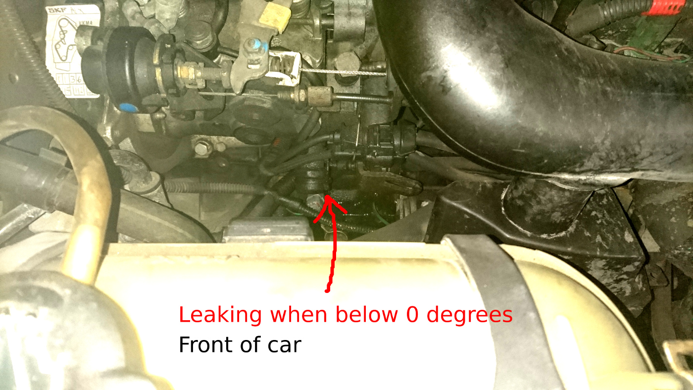

Found that my motor leaks diesel from this point (see photo) when started and below 0 degrees. Leakage stops when motor gets warmer, but motor works irregular like hiccups for the first kilometers. How to solve? Grateful for any tip! [Image: berlingo1.9D.leakage-1.jpg]

My motor is Citroen Berlingo 1.9D from 2001
(22-12-2021, 07:18 AM)gubbenpetson Wrote:  My motor is Citroen Berlingo 1.9D from 2001
The leakage was from a broken rubber sleeve on diesel pump, se picture. Someone knows if it is possible to find an exchange rubber sleeve?

    I think that this is the stop/start solenoid which is available as an assembly - around £60?
