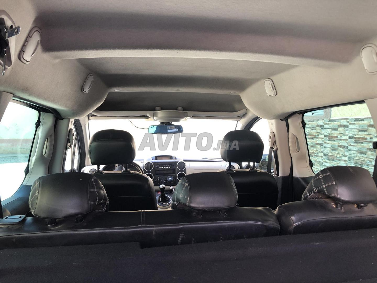

Hello,
i want to retrofit the front over head storage in my '11 Berlingo Van. Is it possible? I found this part number: 8301AW. What else do I need? Screws? Brackets?
[Image: 10093072278?t=full_hd]
[Image: 00072048.jpg]
Best regards,
Jan

No brackets as such, other than two black plastic spacers for the inner visor clips. There's one T30 torx bolt at either side near the doors, and T25 screws behind the darker grey panel that houses the cabin light. The sun visors hinge and also the visor clips provide fixing to the roof as well
