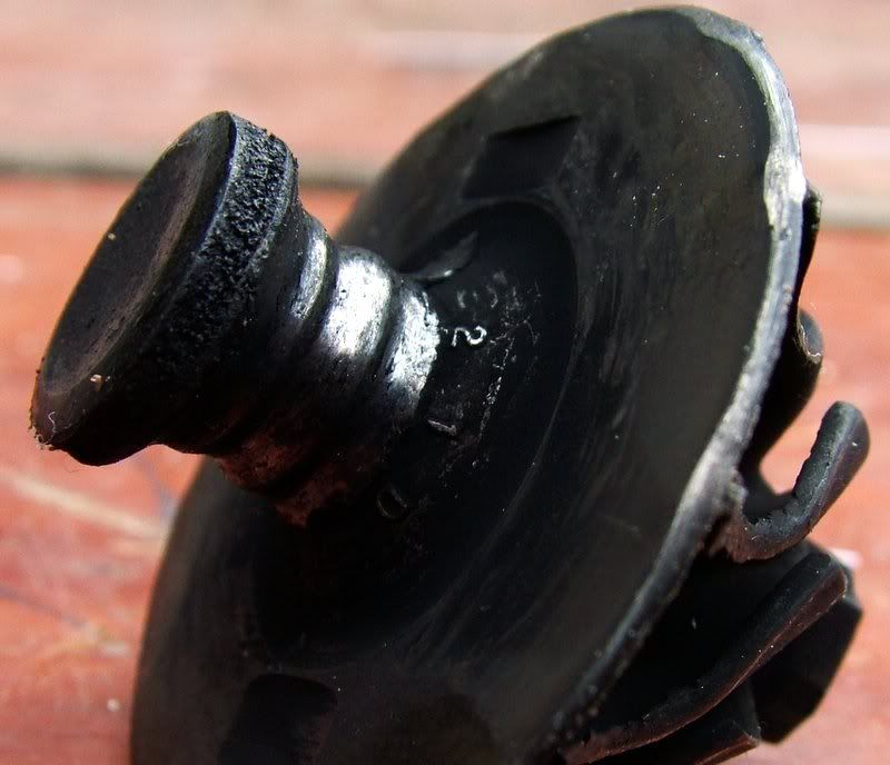

OK I have had a chance to look tonight ,I took the air input pipe off and had a look inside ,,"Oh dear" I said to myself, well maybe a bit stronger language then that, it looks as if the centre shaft has unscrewed because it is sticking out of the impeller about an inch and the whole impeller is loose so looks like a new turbo insides needed.On that note I am off to the fridge to drown my sorrows and wallow in self pity.
I took the turbo off Today the shaft has snapped in Three places I have some photos is anyone is interested in seeing the carnage let me know and I will post them here

If like me you do not like the thought of spending money then look away now
[Image: DSCF3180.jpg]
[Image: DSCF3179.jpg]
[Image: DSCF3178.jpg]
[Image: DSCF3177.jpg]
[Image: DSCF3176.jpg]
not sure what went wrong yet probably starved of oil
That's a real bummer,but it's nice to see a turbo from the "inside".I hope it doesn't break the bank.

Looking at the colours on the forth photo I would have thought overheating due to oil starvation?
2012 Iron Grey XTR 110 with lots of bits and bobs.
Yes well cooked and the rotor has broken up so the bits of that will be ...somewhere!?? :O :eek:
Painful to look at BUT this is what can happen if you don't use the right oil and change the filter regularly.
I'm not saying that that was the cause in this case though.
