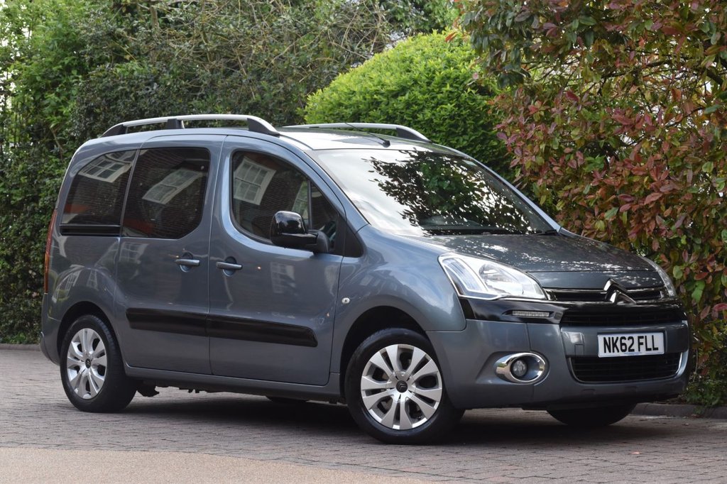

At a 2013, you are probably a facelift vehicle.
Pre-facelift - Foglights and headlights
[Image: 2011_citroen_berlingo-pic-48753622566596...4x768.jpeg]
Facelift - LED daytime lights below the headlights
[Image: 96735505.jpg]
I can tell you for sure that the pre-fl \ fl tail lights are the exact same shape, so that part isn't an issue.
The Multispace uses a different rear door arrangement than most vans, being a hatch eather than the van's double doors. The lights are definitely a different shape on vans, hinges would be different for doors, etc.
I'd be surprised if there's any difference in the panel shape between pre-fl \ fl, but not having tried to swap them myself I can't be sure.

Thanks shtu! That's been really helpful.
I definitely have a facelift version of the MK2 then.
