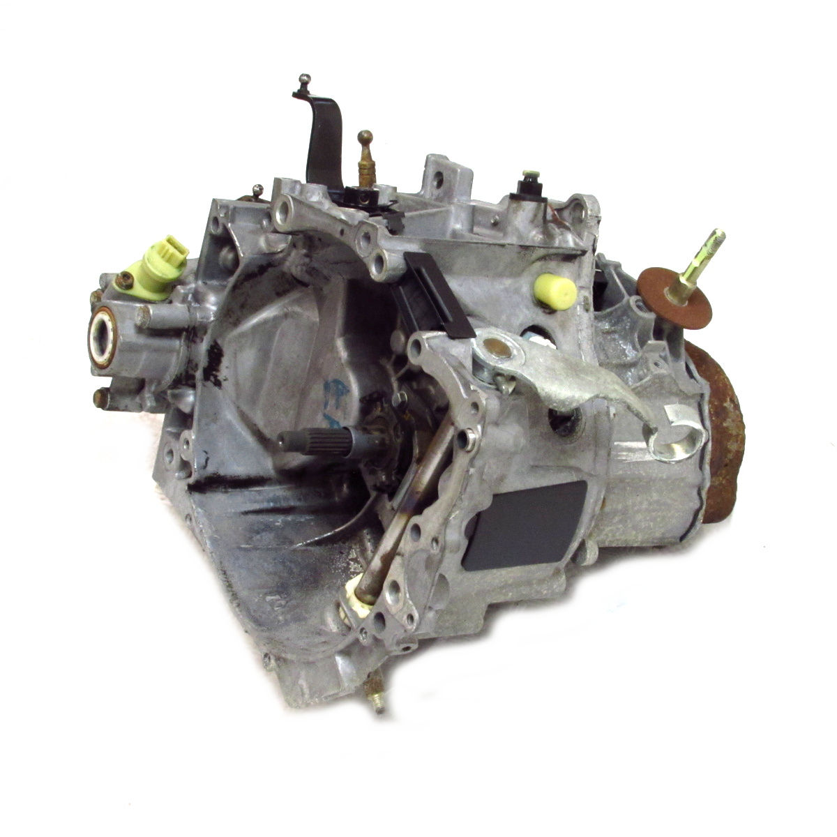

(01-04-2024, 03:45 PM)evdama Wrote: Some pictures might help a diagnosis from someone in the know
Not mine but this part, thanks

Do you mean the bolt-on housing on the far left of this picture?
(slightly different box than the B9, IIRC there isn't a speed sensor on there but close enough to get the idea)
I don't think the diff or bearings can move with that removed, but the parts diagram shows a seal between the housing and the rest of the gearbox. Chances are a look at it tomorrow, loosen everything, and try again will see you sorted.
(edit - as usual, the parts diagram is split across 317 categories, so it's not too esy to see the exact parts in there.)
