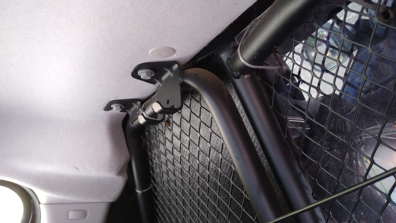

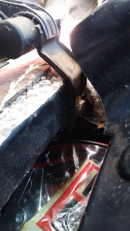

Its do-able dependant on your ability but may not be the ten minute job it ought to be.
The top mounts will be there but you will have to find them through the upholstery.
[Image: IMG-20250630-140718174.jpg]
They may be ready threaded but if not
you  may need some captive nuts  inserted to put the bolts in.These would be expensive from the dealer unless you can think outside the box.
The lower mounts could be a different story as the  van has the rear passenger footwells plated over- there may be nothing to bolt the bulkhead to
[Image: IMG-20250630-140916932.jpg]
Bear in mind the bulkhead significantly reduces the available legroom in the front
Also beware its not symmetrical so lhd and rhd versions might have any usable mounts switched athough they could be there underneath-do you have the spare plastic covers in the top photo?
Given the uncertainty I would make my own from timber as I have done in my previous three vans.
This one had one ready fitted .Other than the opening hatch I wasnt over impressed.

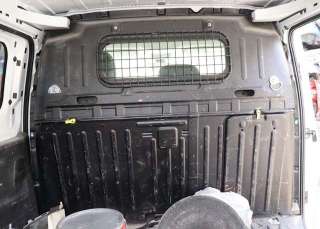

This is the wall i have now
[Image: l341909a.jpg?t=thumb]
Take the glass out? Easy enough to fit an edge trim to the hole so it looks factory, eg, https://www.kitcardirect.co.uk/products/...el-trim-3m
Otherwise, you're probably the only person in the world that wants to do the swap, so you'll just have to take a close look at both and decide.
