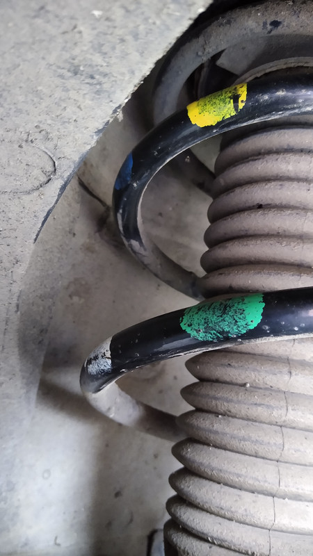

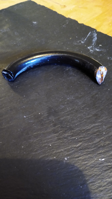

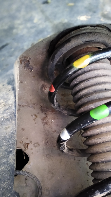

[Image: IMG-20260923-181923910.jpg]Ns spring snap
This nearside went recently while slowly manoeuvring unladen on smooth tarmac.I spun the steering onto full  left-hand lock,braked to a stop and it popped the top off.
I'm thinking a dodgy top mount allowed the spring to twist instead of rotate?
It's done 73k and the running gear is otherwise silent.
Its a knackered top mount that causes the spring to break like that. The flaw in the metal would not help it either.

It's a problem with this type of design generally. The spring takes a smaller radius for the last turn or so to meet the top mount, and they always crack at the change in curvature. Seems to be a point of extra stress in the manufacture.

(23-09-2026, 06:09 PM)evdama Wrote:  Thanks both,some sound advice
Those Yikes Pikavent are out of my league even to sell on.
I need to keep outlay to an absolute minimum for a while after the alternator debacle
I get the point about the eBay ones
There are Seeley and Laser ones around £50 which are 1000kg rated as opposed to not rated at all. Would these be better enough?
If you're going to replace the spring, it's always best to replace the top mounts while the assembly is out.

I think the state of the UK roads also has a lot to answer for with snapping springs. Been through loads of cars since I first starting driving in about 1980 and never had a spring snap on any of my vehicles until in recent times had both a front and rear go on my B9 Multispace. Also had to help my eldest son replace one of the front springs on his VW Golf that had snapped recently.
