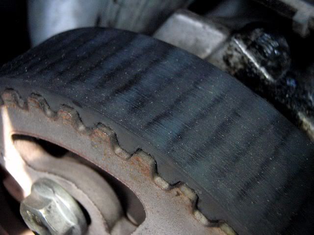

Having got home I have opened the timing case to inspect the cam belt. Two options... A 70,000mile old cam belt or a three month old one... What was it to be? I assume the difference between a 70,000mile and a 3month cam would be immediately apparent?
There are no tears, rips or anything scary like that.
It looks in great condition and seems new to me, so here are some photo's, I'd like to ask your opinions!?
[Image: P4300001.jpg]
[Image: P4300002.jpg]
[Image: P4300003.jpg]
Im not rubber expert but there could be tiny fractures along the belt if it is too old. Obviously, signs of wear will include fraying, thinning and changes in texture along the belt.
The belt itself does look ok from here. Just check for it being shiny, any cracks and importantly, any contamination such as oil(!!)
That is a brand new belt, pulley in the last photo looks good too Smile good news all round me thinks Smile

(30-04-2011, 01:00 PM)MattFreeman Wrote:  The gentleman I bought it from told me on the phone that it's had its second cam belt fitted just three months ago.
Hi, MattFreeman.
Please, rotate pulley of crankshaft by hand using appropriative wrench or tool. During rotation see on a outer surface of a belt.
If you'll not find letters, figures or logos (like Dayco, Gates etc) on a outer surface of belt, age of belt >= 1 year.
I had tried to rotate the belt, but only by hand and I gave up.
So I started the engine without the cover on and looked for any writing.
There was a logo and or text that flashed past at 1,000/min.
Not bad. Previous owner may be do not lie Smile
