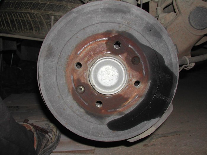

Can't see the image.However,every Berlingo I've done had screw retained drums.
There should be a torx screw holding it in place. If the screw is out and it's still stuck whack the mounting face a few time with a hammer them tap round the circumference.
[Image: attachment.php?attachmentid=11233&stc=1&d=1254328590]
It was the centre hub nut that held it on. Borrowed a set of big sockets and it was a peice of cake.....maybe someone retro fitted different drums and hubs for some reason. :woop:
