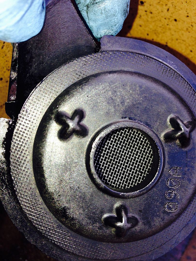

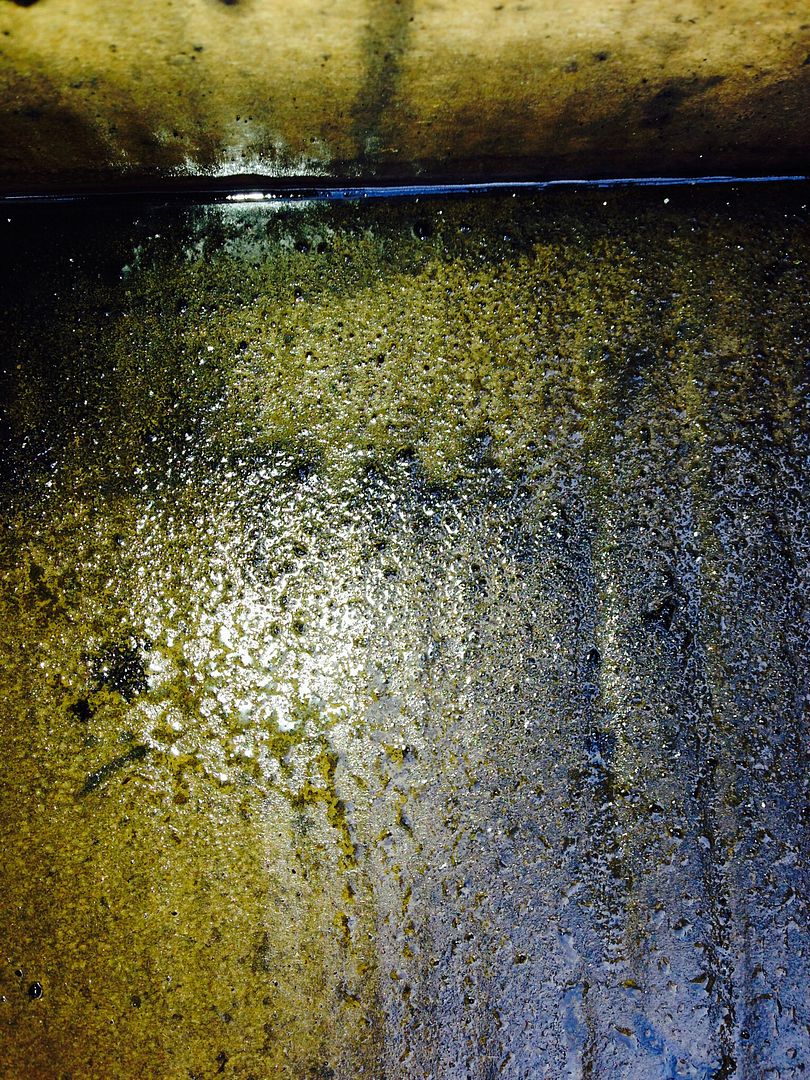

Had this on a C4 Picasso 1.6 HDI about 2 weeks ago. We took the sump off, and this is what the oil pick up looked like in the sump
[Image: c45b9966c86548637e278abab009235e_zpsb6755a68.jpg]
[Image: 5109437eea6f1393adf47d47b4de5234_zpsbb2cf064.jpg]
After about 20 mins of cleansing
[Image: 26808d4f2b2f30437a88f872f053e433_zpse6eeb623.jpg]
I washed all the debris into a cardboard box, and this was what came out
[Image: c0542d4ad8885f63368d5ff43d37e711_zpsa9964d72.jpg]
No issues with oil pressure since.
I would say that on this vehicle , the turbo failed several weeks previous to this, but the sump & pick up we're not cleaned.
WOW that's bad not a good service record on this C4 then Confusedcratch:
67000 miles and a full dealer history actually, I reckon it was caused by a very blocked dpf and the downer just carrying on driving the car regardless of warning lights.
I see he got what he deserved then just one Q as i don't know did it not go into limp mode
Yes it had been in limp mode for weeks Sad
As a retired mechanic,Lightys' post does not surprise me.Some owners ignore your advice,thinking you're after more money,then come back with a blown engine,badly scored flywheel(in clutch cases),& varying degrees of "misfortune".I fiound it very hard to be sympathetic. It's a lovely job,spoilt by a few customers.:brickwall:
