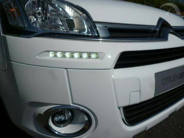

Hi all,
I've just got hold of a 2010 berlingo multispace front bumper.
Don't get it till Tuesday but I'm still missing parts .
This will be replacing my bog standard vans bumper
It did have the fogs and also had led drl units mounted in bumper..?
It's the newer bumper shape with the chrome strip under the light?
Both fogs and led units are missing,
but my problem is I can't seem to find part numbers or sizes!
if I can buy cheaper drl units as I'm sure citroen will be asking over £100...?
I know I've got to use lexia to switch on fog light switch.
I've got the fog lights and mounts but I need the drl units to finish then I can fit it.!
Any help would be great

No Driving lights in a 2010 model, it did have fog lights.
I DO MISS MY BERLINGO Heart
[Image: B8FBA378-A0FA-4872-AAA0-E160DEEB134B_zpshnlkzobe.jpg] this one?
63 plate Berlingo working hard.....
Are you sure it's a 2010 model? As philip said, only restyling model has DRL's in it:
[Image: media_zps98433be1.jpg]
I can get you the part numbers but DRL's won't fit in a 2010 bumber..
The Citroen fitted DRL's did not appear till after March 2012
