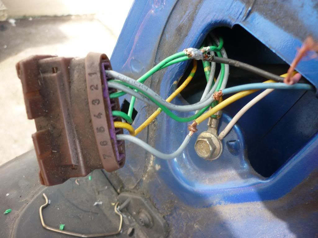

and this one, that you will see on either side lamp, the connector got some numbers for each cable,that is:
1= fog light, to be connected with tow hitch cable in blue.
2= brake light, to be connected with tow hitch cable in red.
3= lights, to be connected with tow hitch cable, left hand side in black
right hand side in brown.
4= reverse light.
5= earth, you can tap on it, or just earth it somewhere else with white cable from the hitch.
6= indicator, to connect with yellow for the left side, and right side green.
[Image: P1000904.jpg]
hope that helps.
